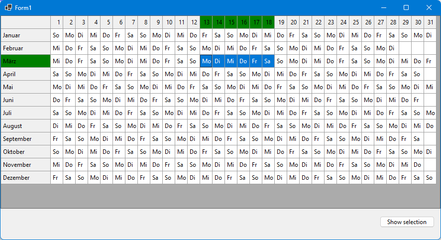

    A simple selection range is inside a month:

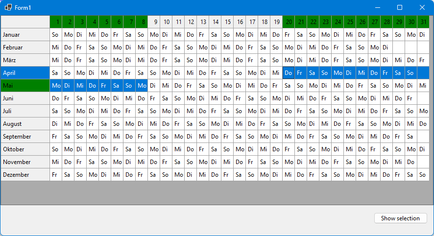

    It gets interesting when selecting a range from a date in one month to the date in another month, with a column gap between:

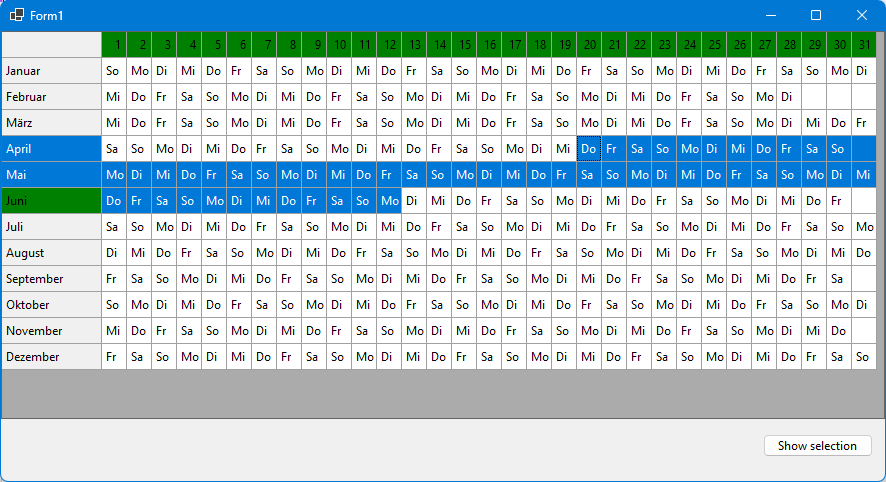

    You can also select a range including a full month:
    To make it more complicated: you can also create selection ranges by starting at the end date and dragging the selection range above to the start cell.
    This all is achieved by tricking the C1FlexGrid rendering: “IsCellHighlighted” is overridden and returns true for all selected date cells. Internally, the “C1FlexGrid.Selection” might contain completely different//inverse ranges. But “Row/Col” and “RowSel/ColSel” provide the relevant information.
