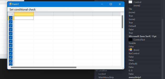

    For example, I have any table of data, I want all rows with data ‘Red’ to be checked. So I want to use the OwnerDrawCell event to control the checkbox image. In the old version, I can use by assigning Glyphs[GlyphEnum.Checked] to e.Image. But in this new version, it is not possible.
    And I discovered another small error that the checkbox image is zoomed according to the font size, you can see the example image below:
  • Posted 22 August 2023, 2:26 am EST
    As per our understanding, you only want to show the checked image in the fixed column (for rows with specific data). For this, you can use the OwnerDrawCell event to validate your condition and set the image accordingly. Please see the updated project for reference (FlexGrid.FixedCheckBox.CheckImage.zip).
    FYI, the default checkbox in the C1FlexGrid is scaled with the Font size for uniformity between the text and checkbox. This is the designed behavior of the C1FlexGrid. However, if you directly assign the checkbox glyph as the image of the cell, it won’t be scaled with the Font size.
