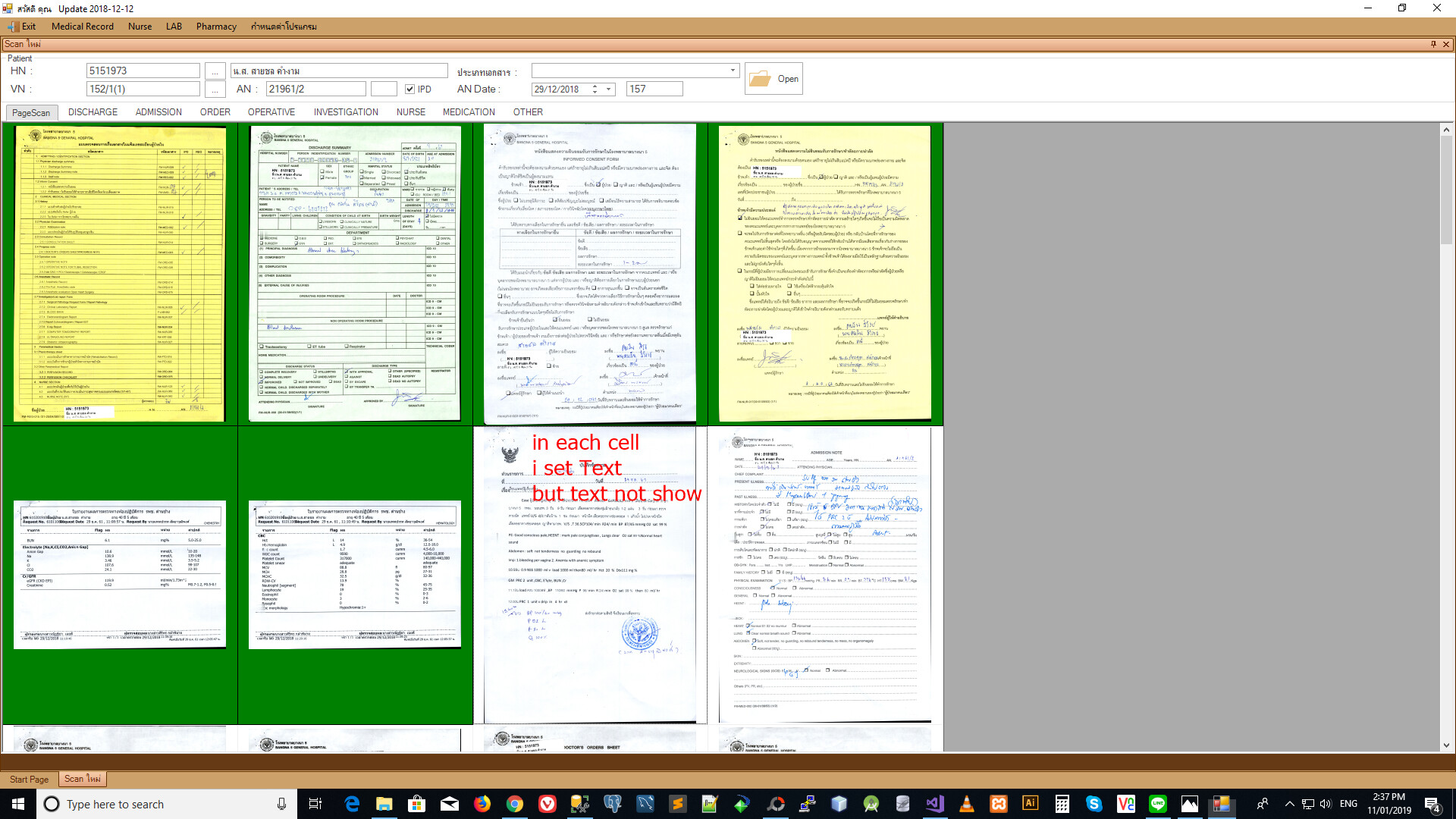

    Sorry, I am not sure whether I understand the issue. You have a grid and each cell contains an image of a document? And you also have columns which show the filename? I don’t see these columns in the screenshot, so it seems that they are invisible?
    Basically, it should work. So I assume there is a bug in your code.
    If it does not work, try to create a small sample project and post it here.
  • Posted 11 January 2019, 5:07 am EST
    i want to show image and text same cell to show user
    and another column i set filename to programming

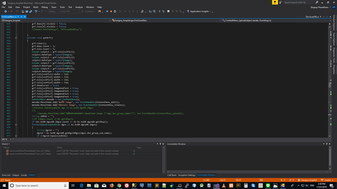

    and i find cause of FlexGrid can’t show text in field image
    i have script
    //Column colpic1 = grf.Cols[colPic1];
    //colpic1.DataType = typeof(Image);
    //Column colpic2 = grf.Cols[colPic2];
    //colpic2.DataType = typeof(Image);
    //Column colpic3 = grf.Cols[colPic3];
    //colpic3.DataType = typeof(Image);
    //Column colpic4 = grf.Cols[colPic4];
    //colpic4.DataType = typeof(Image);
    and
    //grf[i, colPic1] = resizedImage; old script
    grf.SetCellImage(i, colPic1, resizedImage); new script
    it show text and image
