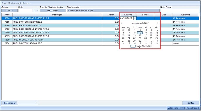

    When I select a cell, automatically set a date (today), but I don’t want it.
    I want that set a date just after a user select the date and option to clear the selected date.
    Thanks a lot.
    My form in attachments

    The default editor for the DateTime column is MS DateTimePicker and it is the default behavior of the DateTimePicker.
    To achieve your requirement you can use the C1DateEdit controls as the Editor of the DateTime column.
    c1DateEdit1.EmptyAsNull = true;
    c1DateEdit1.NullText = "";
    c1FlexGrid1.Cols[dateTimeColumnIndex].Editor = c1DateEdit1;
    Please find the attached sample implementing the same.
