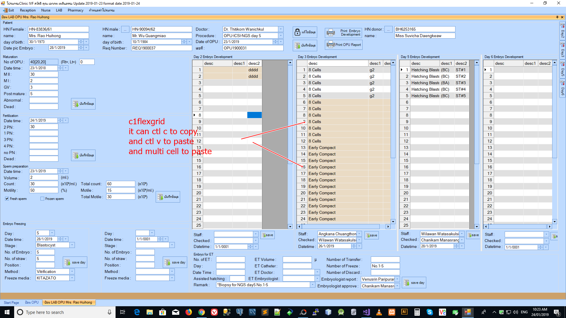

    i want to copy form another cell and paste multi cell

    As per my understanding, you want to copy the data of single cell and paste the data into multiple cells. You can override the “Ctrl +V” in the “KeyDown” event of the C1FlexGrid like below.
       private void C1FlexGrid1_KeyDown(object sender, KeyEventArgs e)
                if (e.KeyCode == Keys.V && e.Modifiers == Keys.Control)
                    C1.Win.C1FlexGrid.CellRange cr = c1FlexGrid1.Selection;
                    cr.Data = Clipboard.GetText();
    Also, I have attached the sample for you. Please explain, if I am missing something.
