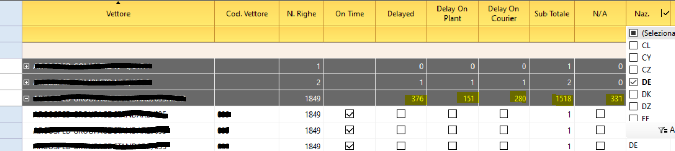

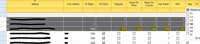

    We have a grid with some groupings created by code, following:
    https://developer.mescius.com/componentone/docs/win/online-flexgrid/group.html
    It also has Sum Aggretations defined in some columns to show subtotals by group.
    We have an issue that if we apply a filter on the column, the rows shown in each node change but the subtotals of the group does not change. I would believe it is because the filtering is only making the rows invisible but are still considered in the Aggregations calculation.
    Is there a way to change this behaviour? Thanks
