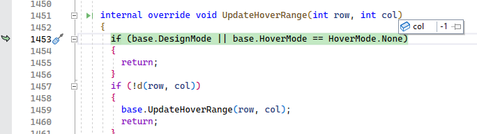

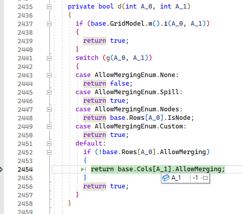

    Visual Studio disassembly tells me that a column is accessed with Index = “-1”:
    This is a bit up the callstack:
    The grid has initially 0 rows and cols, and “AllowMerging” is set to “AllowMergingEnum.FixedOnly”.
