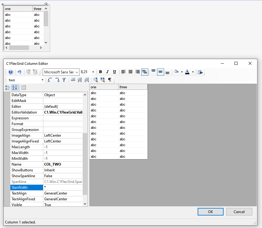

    Hi C1,
    when setting a StarWidth in the grid column designer, the col display width shrinks to “0” and it is not visible any more. It can still be selected in the combobox.
    In my sample, there was enough space left in the client area to apply the StarWidth to the col, but it shrinks anyway.
    I suggest to always display it, even if no MinWidth is set - with a default width of e.g. 100 pixel.
    A similar problem is the handling of invisible cols (also hidden, though at design time it would be more helpful to show them, e.g. with a gray background). But this issue exists as long as I know the grid, so I don’t request a change here ;-).

    Sorry, it was a bit my own error: the width of the grid cols in the designer is calculated based on the width of the parent control.
    I designed a UserControl which contains only a single C1FlexGrid with Dock=Fill. This user control has the default size because it is dragged to the proper size in the place where it is used.
    In my sample, the column width sum is larger than the parent size, so the column gets invisible when setting the StarWidth, though the column designer window is much wider than the parent control.
    I understand what’s happening here, and I am not sure whether I should call it a bug. But I don’t like the fact that the column is invisible afterwards. Is there anything you could do to show them at design time?

    In your attached screenshot, initially, two columns are visible only so it is not visible when setting the StarWidth of Col 2. In this case, you can adjust the control’s width or use the MinSize property of the Cols to be able to see the second column. I have shown the same in the attached GIF, please have a look.
