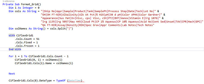

    How can I change a columns datatype to a date format at run time in a C1FlexGrid? I tried using typeof(datetime), which doesn’t work.
  • Posted 12 September 2018, 2:56 pm EST
    C1FlexGrid1.Cols(8).DataType = typeof(DateTime) is what I tried.

    Thank you for your reply. Grid is not bound to a data source (e.g., it is unbound). When I use this statement C1FlexGrid1.Cols(8).DataType = typeof(DateTime), the error I receive is " ‘Date’ is a structure type and cannot be used as an expression." The structure referenced is System.DateTime. I’m using VB.NET 2015.
  • Posted 13 September 2018, 11:51 pm EST
    In VB, you need to use GetType(DateTime) instead of TypeOf(DateTime) to get the type of the argument.
