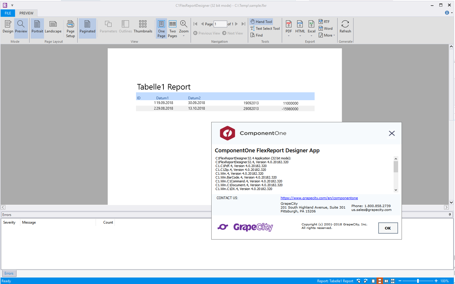

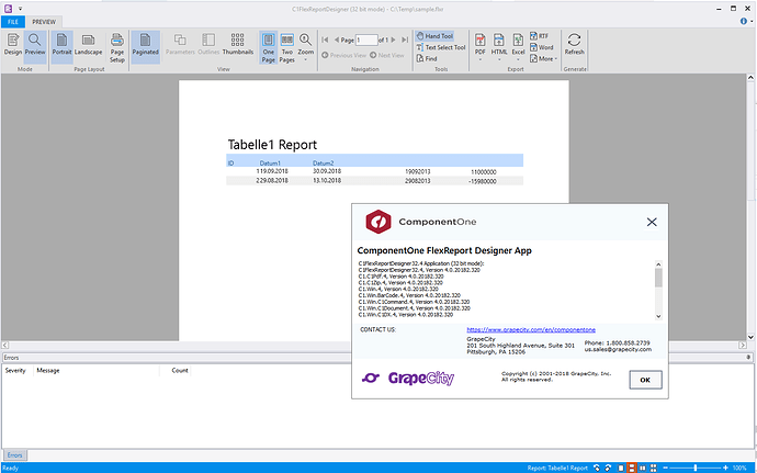

  • Posted 24 September 2018, 3:50 am EST - Updated 13 August 2025, 11:13 am EST
    Hi Esha,
    I tested it on three machines (Win10 1803 x64, Win10 1803 x32, Win7 Enterprise x64). Same result on all machines.
    Attached is a new sample: I added a new field with this formula:
    Format(Datum1, "dd.MM.yyyy") + "-5"
    The result is “19092013”, which is the formatted date 19.09.2018 minus 5 (years):
    Here is a reworked sample, including this new calculated field:
    sample2.zip
    Maybe related to locale settings?

    I could observe the issue on a machine with German locale and Win 10 1803 version.
    I have escalated the same to the concerned team [Internal Tracking ID: 344719] and will let you know once I receive an update.
