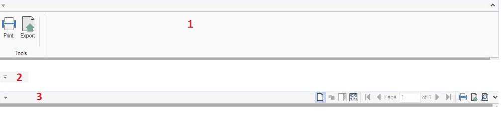

  • Posted 28 May 2019, 3:33 am EST - Updated 4 October 2022, 1:11 am EST
    Dear Esha,
    Perfect.
    I discovered also that all can be minimized over no 2 as you can see in the attached picture line no 3.
    Can you please support with the VB.NET code to get this done.?
    I want to open the FV directly like no 3.
    Said Nai
  • Posted 28 May 2019, 4:55 am EST
    Hi Said,
    As per my understanding, you wish to know how 3 from the screenshot can be implemented using VB code. This can be done as follows:
       Me.c1FlexViewer1.Ribbon.Minimized = True
    The Ribbon can be minimized to achieve that layout.
