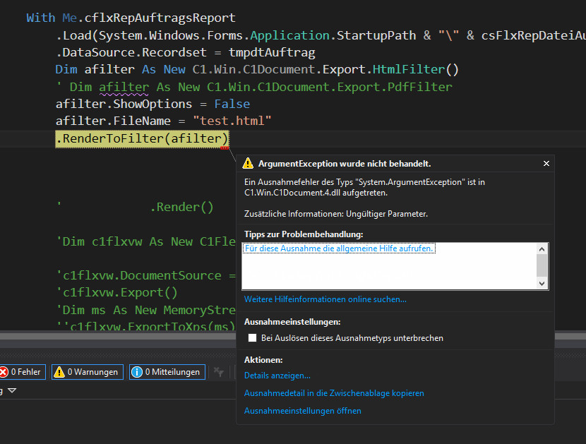

  • Posted 21 February 2019, 1:26 pm EST
    I tried this (before my posts) but I got an error …
  • Posted 21 February 2019, 1:35 pm EST - Updated 4 October 2022, 12:57 am EST
    as posted several times it works if I take a pdffilter but not with a htmlfilter:
  • Posted 21 February 2019, 4:38 pm EST
    it depends on the kind of report if the htmlfilter works or not. Simple reports w/o datasource work, when i use a report with a dynamic datasource the htmlfilter produces an “parametre” error. whyever
    I gave up in the meantime, since (manually) html exported reports look completely senseless when set to outlook s htmlbody … so my original idea seems not doable. So I ll switch to the old version of creating an email with an attached pdf…
