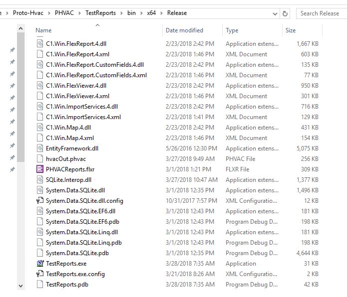

    These are the files I am distributing:
    Do I need to install SQLite on the target machine? and update the machine.config.file? I do not need to do this for any of the other database interactions I have in my application.

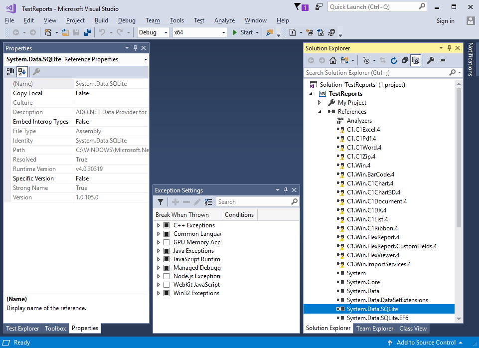

    Also as I can see you already added reference to the System.Data.SQLite.dll, BUT please set its “Copy Local” property to True, so when project is build dll will be copied to output folder.
    I have attached corrected project.UserSample.zip
  • Posted 27 March 2018, 1:54 pm EST - Updated 4 October 2022, 2:53 am EST

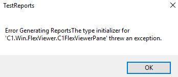

    What I sent did have “copy local” set. When I opened your version, I needed to repoint to the SQLite files as well as C1.Win.C1DX.4. Now I get :
  • Posted 27 March 2018, 3:07 pm EST - Updated 4 October 2022, 2:53 am EST
    Please see attached image
    CopyLocal not set, this is your original project and when solution is build System.Data.SQLite.dll is not copied to output directory.
    I attached another version of your project it differs from original (your) version only by one string in TestReports.vbproj:
    False
    …............\Program Files\System.Data.SQLite\2015\bin\System.Data.SQLite.dll
    True
    ^^^^ This string is added
    UserSampleOrig.zip

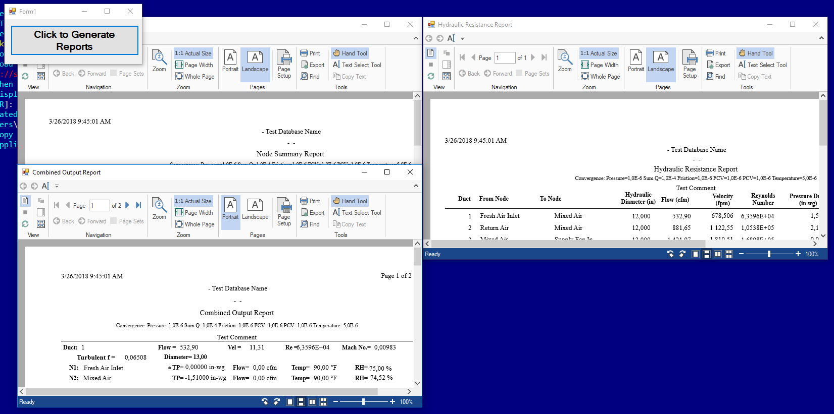

    -) Now application runs without errors see attached image
