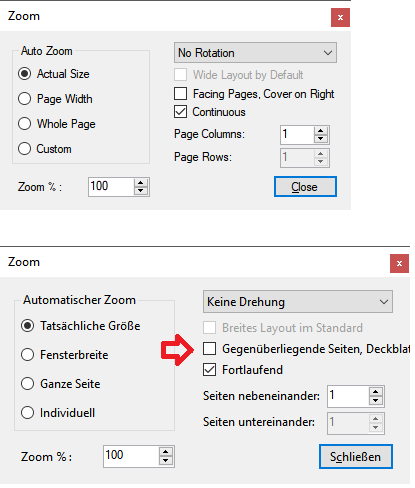

    is there any chance to control the layout of the zoom dialog in C1FlexViewer? After translating to german, the label “Facing pages, Cover on right” is clipped.
    I tried to insert a linebreak in this string, but then the next label “Continuous” is clipped.
    Attached screenshot contains the untranslated dialog and our attempt to convert to German. The german window is a bit larger, because we changed the default font of our application to the windows font.
    Would it be possible to specify the size of the dialog? This way we could make it wieder. Then, the “rotation” combobox should be anchored left and right (we have larger texts here, too) and the “Close” button should be anchored right.
    Another solution would be to move the “Continous” label a bit down, so that we could add a linebreak to our label text.

    I could observe the text being cut from the dialog and though adjusting the size of the zoom dialog and the Rotation combobox is not directly possible, I am discussing this with the development team [Internal Tracking ID: 339350] and will get back to you once it is done.

    The issue is fixed with the latest 2019V3 builds. Please upgrade to the same using ControlPanel or C1Live.

    Perfect, works like a charm!
