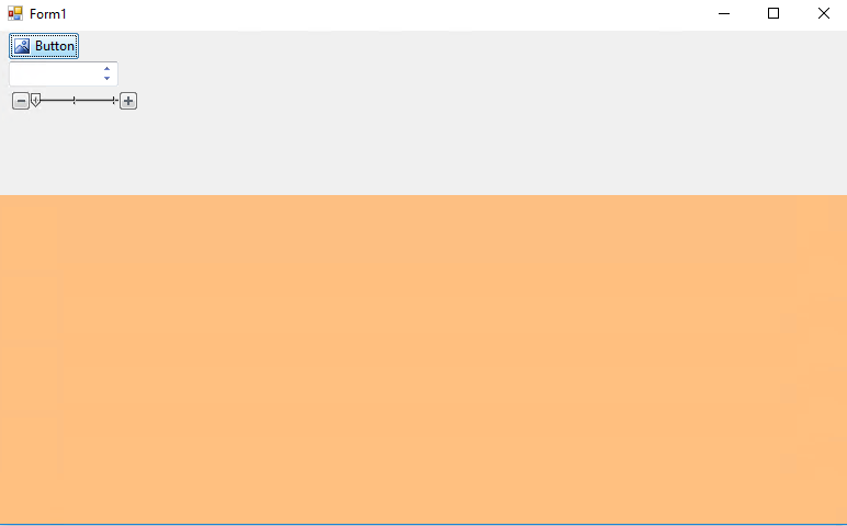

    Hi, Let see if C1InputPanel Set AutoSize and docked. show like attached image.

    I am sorry but I couldn’t understand what you meant but docking C1InputPanel to Top with AutoSize = True shows the following correct output.
    Could you please share what you expect when the control is AutoSized and docked to Top?

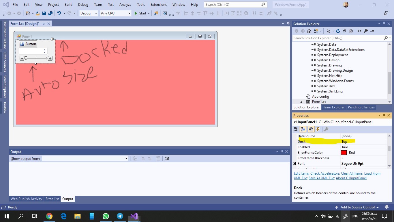

  • Posted 28 April 2020, 3:06 pm EST
    Hi, I see your image, you set only dock top, but if you set autosize=true, the inputpanel resized both width and height. like my image.
    the red area is my form background, and gray area is inputpanel,
    if I set docked top I need to fill the top with inputpanel, not a small area.
    In your image you don’t set auto-size, you can see the height is not resized to right height value.
