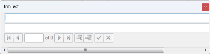

  • Posted 20 November 2023, 11:55 am EST - Updated 20 November 2023, 12:00 pm EST
    Hi Kartik,
    I have followed with the following code:
    public partial class frmTest : Form
            public frmTest()
                InitializeComponent();
                Boms oBom= new Boms();
                DataTable dtResult = oBom.GetDistinctBom();
                if(dtResult != null)
                    BindingSource bs = new BindingSource(dtResult, string.Empty);
                    //Set the Binding for the InputPanel components
                    SetInputTextBinding(inputTextBox1, bs, "prefixMattCode");
                    SetInputTextBinding(inputTextBox2, bs, "mattGroupName01");
            private void SetInputTextBinding(InputComponent inputTextBox, object dataSource, string dataField)
                //Set DataSource and DataField properties for the InputPanel components
                inputTextBox.DataSource = dataSource;
                inputTextBox.DataField = dataField;
    But it does not show any thing as the attached photo.
    I want the InputPanel to enable for user to ADD/UPDATE/DELETE record of the Table.
    Duyet Le
