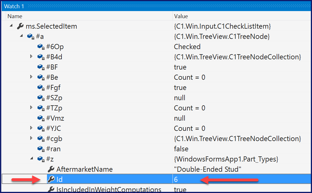

    It’s definitely available via the Watch window. So it should be possible to get this via reflection.
