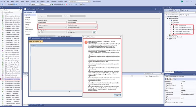

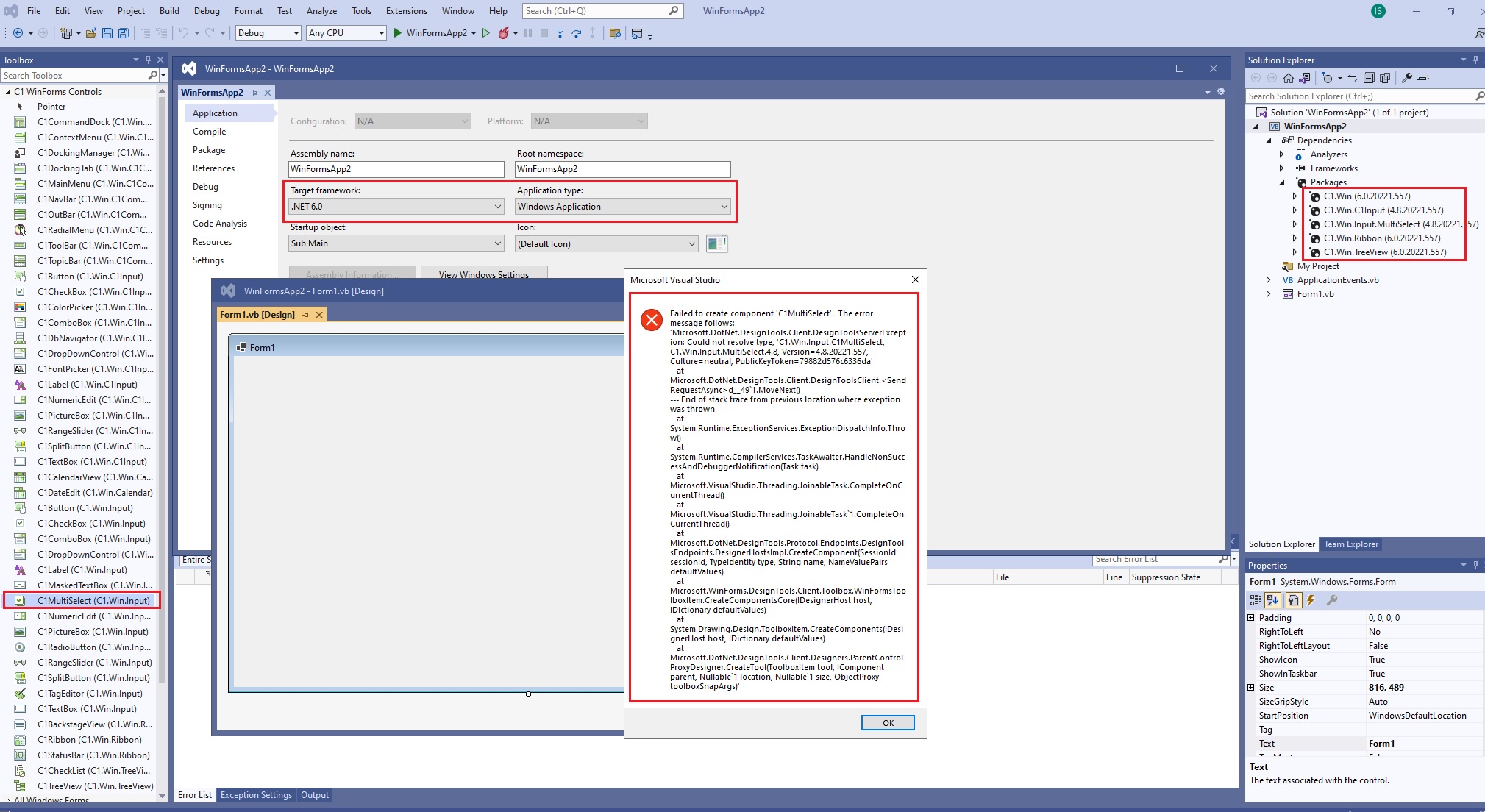

    Does C1MultiSelect work with WinForms in .NET 6.0 ?
    Error we get is in the attachment.

    The error you are facing is observed when trying to use two different versions of C1 controls in the same application. The .NET Framework 4.8 and .NET 6 versions of C1 Controls cannot be used together in an application as it creates a conflict among the C1 assemblies.
    For your information, the C1MultiSelect control is not yet migrated to .NET6. We are getting in touch with the development team to get an update on the migration and will let you know as soon as possible.
