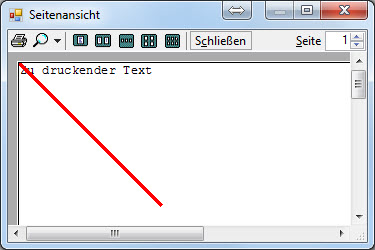

    I want to migrate a VS2019 PrintPreviewDialog to the better featured C1PrintPreviewDialog. The VS PrintPreviewDialog owned a PrintDocument and it is very easy to write a text and draw a line. See the result of this minimum 2 line code in the attached picture.
    Private Sub PrintDocument1_PrintPage(sender As Object, e As Printing.PrintPageEventArgs) Handles PrintDocument1.PrintPage
    Dim g As Graphics = e.Graphics
    g.DrawString(“Zu druckender Text”, New Font(“Courier New”, 12), Brushes.Black, 0, 0)
    g.DrawLine(New Pen(Color.Red, 5), 0, 0, 200, 200)
    End Sub
    Migrated to C1PrintDocument it is not possible to get a “Graphics” object from the “EventArg” parameter, where I can paint.
    “Graphics” is no Member from “EventArgs” !!!
