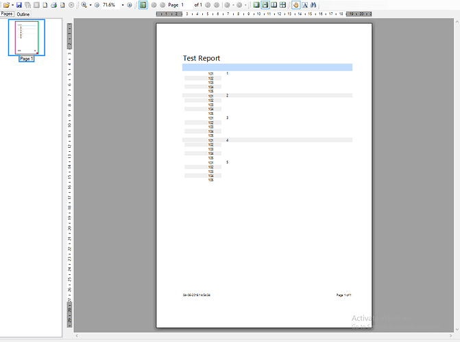

    We used “Test Report.xml” to bind it to a simple SQL database such that the report is rendered as:
    The resultant file from RenderToStream with the two versions (13v1 and 17v3 builds) are attached in “testfile.zip”. Please refer the same and inform us about the kind of rendering issue you are referring to. This will help us assist you in the correct manner.

  • Posted 13 June 2018, 3:15 am EST
    Hi Esha,
    In 13V1 file 101 and 1 is in the same line whereas 17V3 file 1 and 101 are in separate line.

    As per the team,
    C1Report’s TextFilter was significantly changed. To use old version, set C1Report.CompatibilityOptions.UseTextFilterClassic to True
