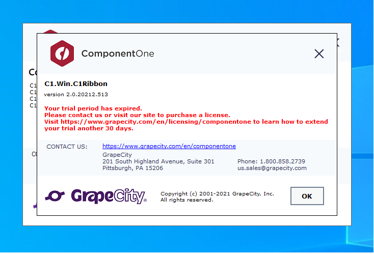

    After updating from version 2016/v2 to 2016/v3 i get this message when i run C1ReportDesigner V2 and the designer quits loading.
    V4 Designer works fine.

    As per your given screenshot, we can see that you are using the 2021 V2 version.
    So could you please confirm which version you are willing to use as you mentioned 2016V3?

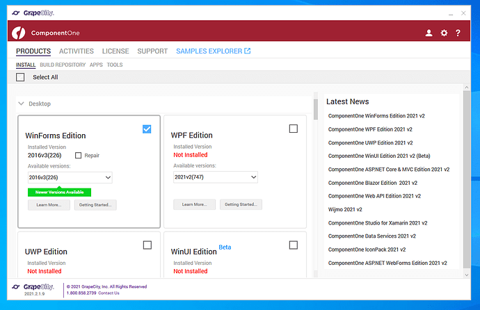

  • Posted 23 November 2021, 9:17 am EST - Updated 3 October 2022, 10:53 pm EST
    No, it was not a mistake by me, here is a screenshot of the c1 control panel that states that i am updated to 2016/v3
    After uninstall, will my license get erased ?
