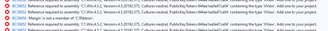

    We are having some issues with upgrading Winform dlls from version 2 to version 4.5.2. I follow the steps provided in this link: https://www.grapecity.com/blogs/version-faqs-for-winforms
    It works for upgrading some of the DLLs but not for all; for instance, I get a lot of build errors for C1Ribbon.dll (see attached picture)

    As per the error, please add the following dll to your references:
    C1.Win.4.5.2.dll
    This would resolve the errors shown in your screenshot. Also, refer the following blog post explaining how migration of an existing application (using Classic Ribbon) is done to the one using new Ribbon:
    https://www.grapecity.com/blogs/migration-classic-ribbon-to-new-ribbon

    Thanks! it worked.
