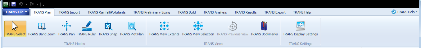

    As a team we are finding that the title bar for the C1RibbonForm fails when we display an open dialog. We are left with the bar being transparent when maximised or black when the application is not maximised.
    This has only started happening since we applied the latest Windows 10 update - Feature update to Windows 10 (business editions), version 1809, en-gb
    To repeat:
    Open an App with a C1RibbonForm
    Set one of the built in visual style themes. i.e. Office 2007 Silver.
    Ensure the app is maximised
    Display an Open dialog
    Result:
    Everything flickers and the toolbar displays the issue mentioned above.
    I have attached a really simple test app based on the default template you ship.
    The video also shows the behaviour.
