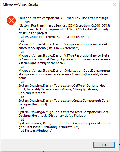

    Without any knowledge of how, the C1Schedule Control has gone missing from my Project’s Main Form.
    This is causing Null Exceptions.
    I have tried to add the Control back into the Form and I get the enclosed Image Error message.
    Your advice is URGENT please?
  • Posted 16 April 2018, 2:06 am EST
    Hello Graham,
    Thank you for sharing the screen-shot of error.
    This is most likely to happen when the version already referenced in your project and the version you are trying to add from Toolbox are different and hence the Visual-Studio prevents that, since the project already have the same dll of some other version. So we suggest you to ensure that the same version of the control(C1Schedule) is loaded in the toolbox and referred in your project.
    To see the version of the items in the Visual Studio Toolbox, move your mouse over any control of Studio for WinForms and a tool tip with the version information will appear. To get the version of your referenced assemblies you should expand the References of your project, click any dll and press F4, this will display the property window which contains information about the version of the file.

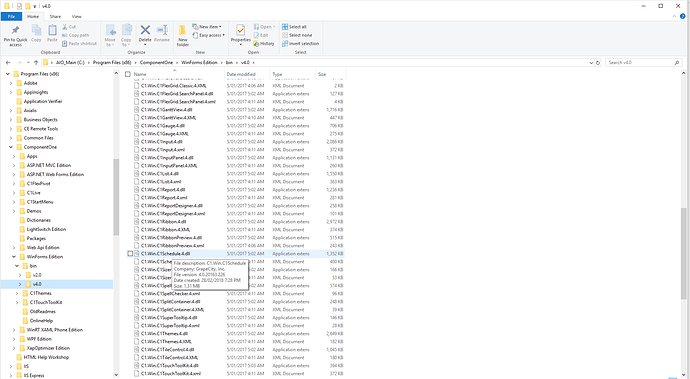

    The Version I have and is Licensed is 4.0.20163.226
    These files reside in C:\Program Files (x86)\ComponentOne\Apps\v4.0
    Then there are Files in C:\Program Files (x86)\ComponentOne\WinForms Edition\bin\v4.0
    These files are Version 4.0.20163.212.
    Please advise on your Draconian Licensing System changes needed before I through it ALL in the bin.
    That is what is getting loaded into the Toolbox.

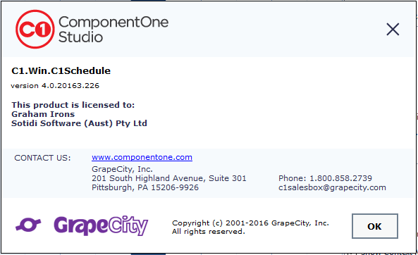

    I need to get some resolution to this Bizarre issue of the missing C1Schedule Control that has lived on my MainForm for many years!
    Attached is an Image of my Licensed C1Schedule Control.
    The DLLs for this Licence are located in C:\Program Files (x86)\ComponentOne\Apps\v4.0
    The earlier Version of these DLLs (4.0.20163.212) that were update using C1Live are located in C:\Program Files (x86)\ComponentOne\WinForms Edition\bin\v4.0
    These are the Files that are getting loaded into the Toolbox.

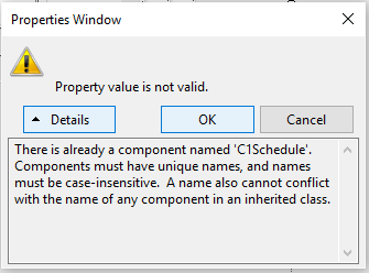

    But if I Add a new C1Schedule Control (4.0.20163.226) it will be named C1Schedule1 and when I attempt to change the Name to C1Schedule, the attached message Dialog appears.
    Now, there is no C1Schedule Control listed in the Form’s Controls. So it hasn’t “slipped” off the form. It has gone missing and yet the Form still thinks it exists.
    The Versioning issue is another thing. The missing C1Schedule Control is the MAJOR issue to be resolved. Interesting to note that C1Calendar Control remains on the MainForm with the correct Version.
