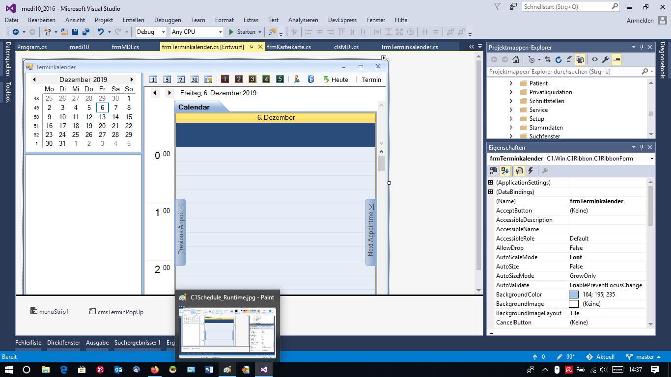

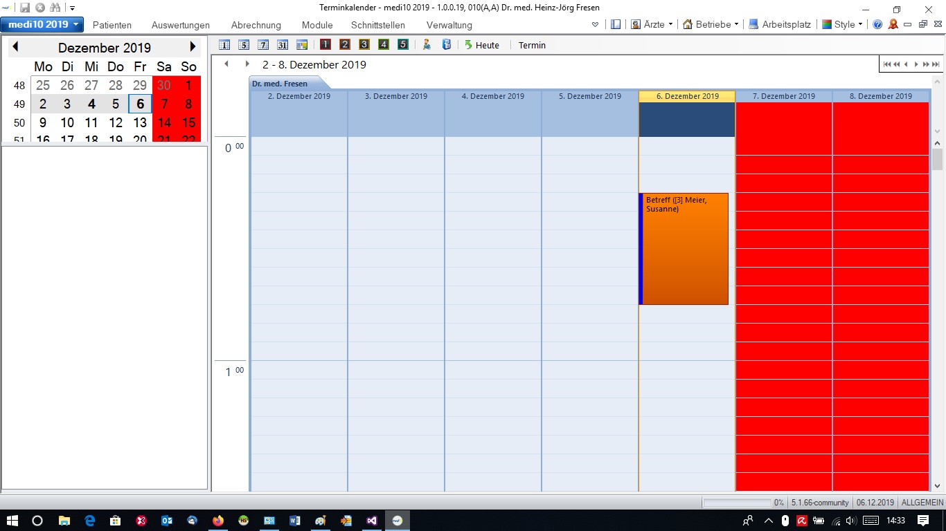

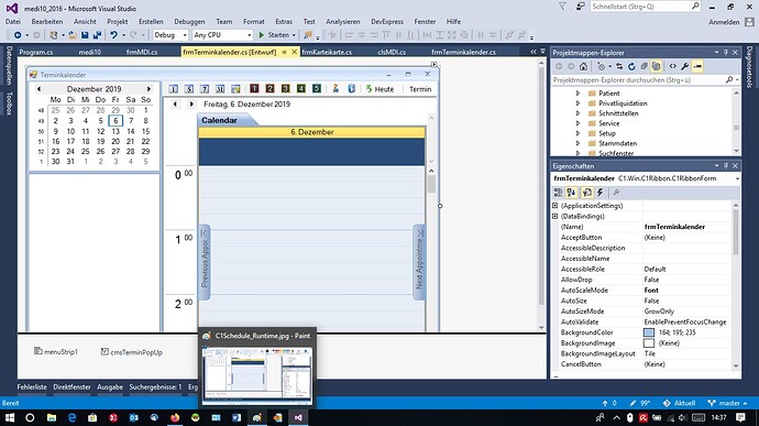

  • Posted 6 December 2019, 9:52 am EST - Updated 4 October 2022, 12:24 am EST
    My previous posting was a little bit premature. I hadn’t noticed your last reply. Sorry for that yet I still have got a problem with the font size.
    My app works as an MDI app. So there’s this superior MDI form and the calendar form as its child. After having changed the font size in the designer as suggested I do get the look I want to accomplish. Yet at run-time it looks quite different. Please notice the enlarged font size of C1Calendar itself and the diminished font size of C1Schedule’s tabs and day names. Please advise.

    Your example works because it doesn’t has to react to any visual style changes. But as I mentioned before I’m developing an MDI app. Our users are able to choose between all built-in C1Ribbon visual styles. These styles are then cascaded down to the MDI children. So, as long as the user doesn’t apply a new visual style C1Schedule works fine. But as soon as I apply a new visual style all changes are gone.
    I understand that I can use the designer to change the font sizes of all themes but I can’t figure out how to save those changes to C1Schedule. When I close and re-open the underlying form, only the most recent edited theme is still present as it is stored in the form’s .resx file. But all the others changes previously made have vanished.
