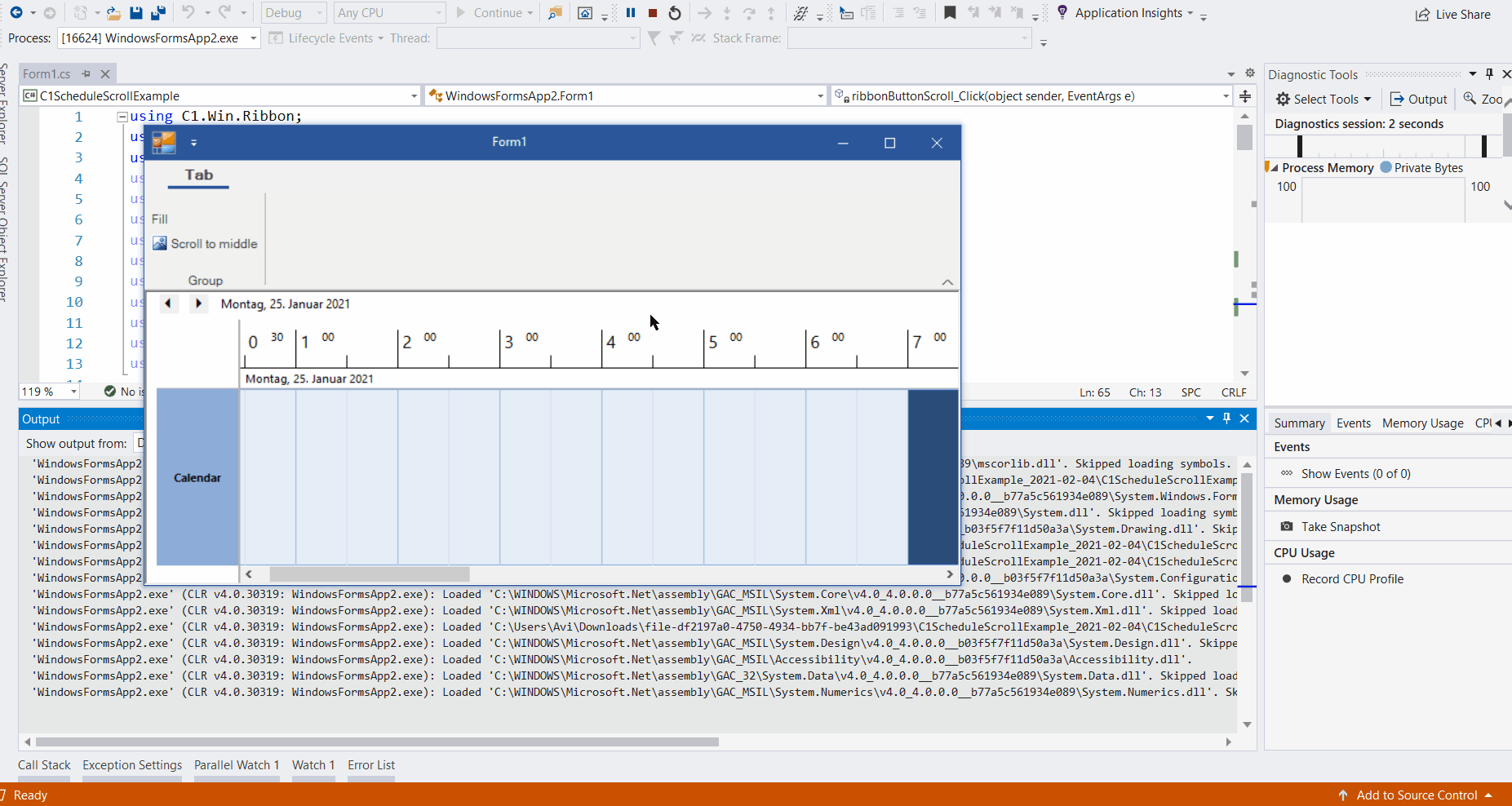

    this method does not help: I want to show a date range from “refdate -x days to refdate+x days” and scroll to “ref date” which is the middle of this range. "
    GoToDate" changes the current visible date range to “refdate + 2*x days”, which breaks my use case.
  • Posted 4 February 2021, 5:01 am EST
    Attached is a reworked sample: first button creates the view range, second button tries to scroll.
    C1ScheduleScrollExample_2021-02-04.zip
