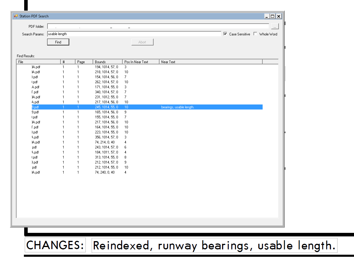

    Im using the sample using C1TextSearchManager to search a PDF. Each hit results in a C1FoundPosition. This object has a NearText field which is the text in the vicinity of the search text. It also has a GetBounds field where the text was found.
    How can I use GetBounds to get the entire text in that rectangle where the text was found?

  • Posted 2 July 2019, 2:47 pm EST - Updated 4 October 2022, 1:05 am EST
    So using the PDF search sample I have the output that says it found the key word “usable length”. It tells me the bounds and the NearText. The document displayed underneath the form is the actual PDF and if I go into edit mode i can see there is a box that contains the entire text “Reindexed, runway bearings, usable length.” The entire text in that box is what I am looking for.

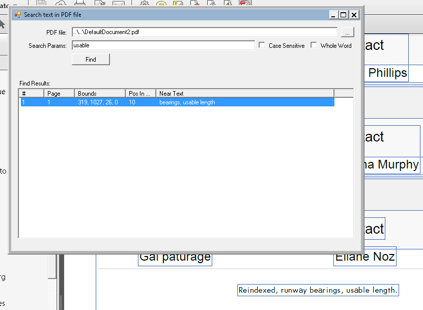

  • Posted 3 July 2019, 5:07 am EST
    When the PDF is opened in edit mode, rectangular blocks are shown around each text string by default to enable editing. This is not related to the search being performed in the PDF via the API.
    I used the SearchText sample (at the default location: Documents\ComponentOne Samples\WinForms\C1Document\CS\SearchText) and followed the steps you have mentioned. Refer the attached gif showing that the text being searched already has a rectangular block around it, before the search is performed.
