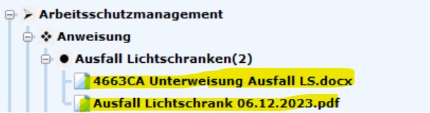

    The picture “Screenshot.jpg” show the target.

    at the moment the documents are uploaded per drag and drop on C1Flexgrid and linked to the nodes in the system in another W.form. Whe the tree is loaded you can see the assigned document to each node as child node.
    The idea is to drag and drop the document directly on a specific node in the tree and update the table for the link behind. To achieve this i need the ID of the targeted node for the document name and the path is done in the previous sample.
    I have attached a picture to show the target. I also marked the documents in yellow.
    I do the remark for the sample: When i drop the file, the node name will be replaced with the path and document name. It will not be show as a new child of it.
