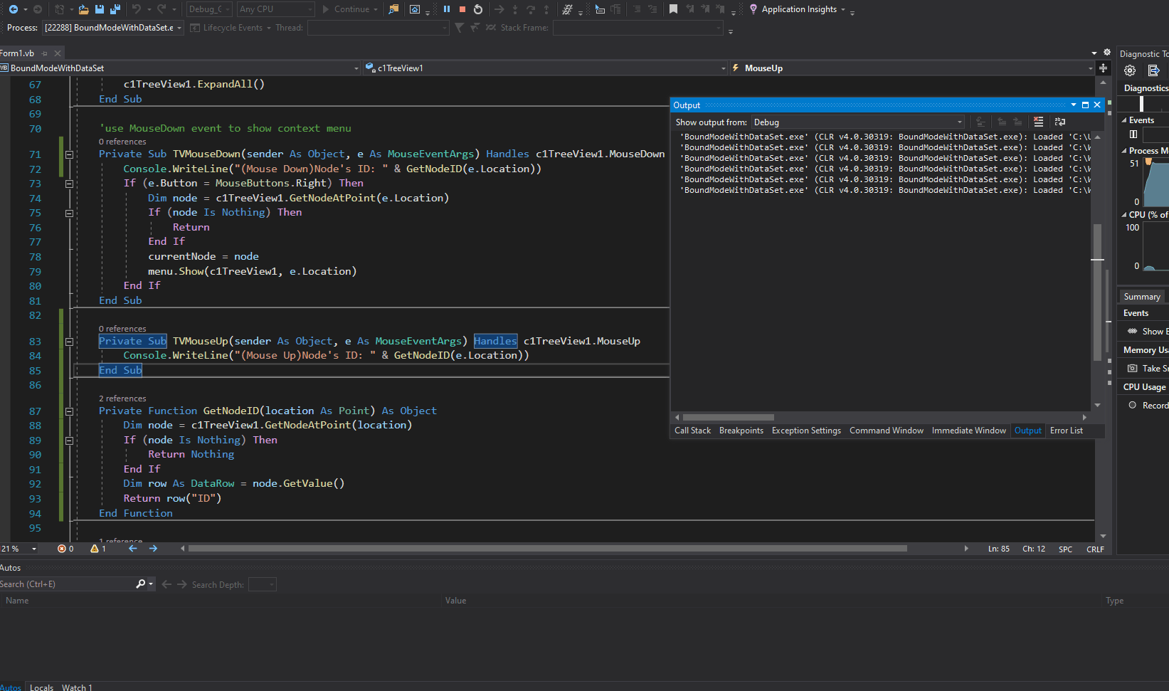

  • Posted 8 February 2021, 3:01 am EST - Updated 3 October 2022, 11:23 pm EST
    Hi Said,
    To get the node that was clicked you can use the GetNodeAtPoint() method of the Treeview in MouseUp or MouseDown event. Then you can use the GetValue() method of the Node to get the data source entry associated with the node. In case of binding with a DataTable, you will get a DataRow object. Once you have the data row, you can get the value of any field including the ID field.
    Please refer to the GIF and modified sample attached.
