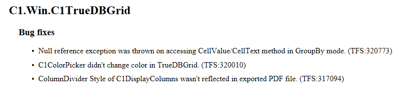

    Hi, we recently upgraded to 4.0.20181.296 and it seems the behavior for the indexer has changed.
    When the grid is in the GroupBy view and we use the grid[rowInt, columnStr] to access the data, if the rowInt is greater than the visible row count, the call will error out.
    Prior to upgrading, the rowInt could be up the the count of grid.Rows
    Please advise, thanks.
  • Posted 20 June 2018, 12:58 am EST - Updated 4 October 2022, 2:31 am EST
    This issue has been fixed in the latest hotfix release 4.0.20181.307. Please refer the attached screentshot demonstrating the same in the change log

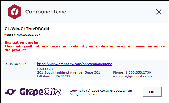

    Hi, thanks for pointing out the hotfix.
    I updated via C1Live, and the fix is working.
    However, now I am getting the “Evaluation version.” nag screens.
    My subscription license is good through August 2018, and presumably should cover the release of this hotfix.
    I tried re-activating the ComponentOne license on my PC.
    I also checked each control using the “About” screen in the designer, and they show the control is registered to me.
    please advise, thanks!

  • Posted 21 June 2018, 8:51 am EST
    I checked the CV1LicenseActivation utility which shows I have the Studio Ultimate license installed
    and i have all the C1.Win.xxx.xxx components in my licenses.licx file for my project/solution including ```
    C1.Win.C1TrueDBGrid.C1TrueDBGrid, C1.Win.C1TrueDBGrid.4
    I did not have the nags prior to installing the hotfix updates via C1Live.
  • Posted 21 June 2018, 8:57 am EST
    Ok, I am good now.
    I ended up deleting all the C1 entries in licenses.licx and used the Grape City License Manager to rebuild the entries using the ‘Update Project(s)’ command.
    Thanks!
