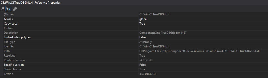

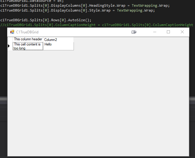

    I didn’t need to modify the project. It doesn’t expand the height to show all text as you can see from the attached screenshot. I can’t go back and run with the previous version of the control because I don’t have it any more, having upgraded to the latest and greatest. I’ve also attached a screenshot of the properties for the C1TrueDBGrid DLL used in the sample project.

    Sorry, the forum didn’t post my images. Here they are, hopefully.
