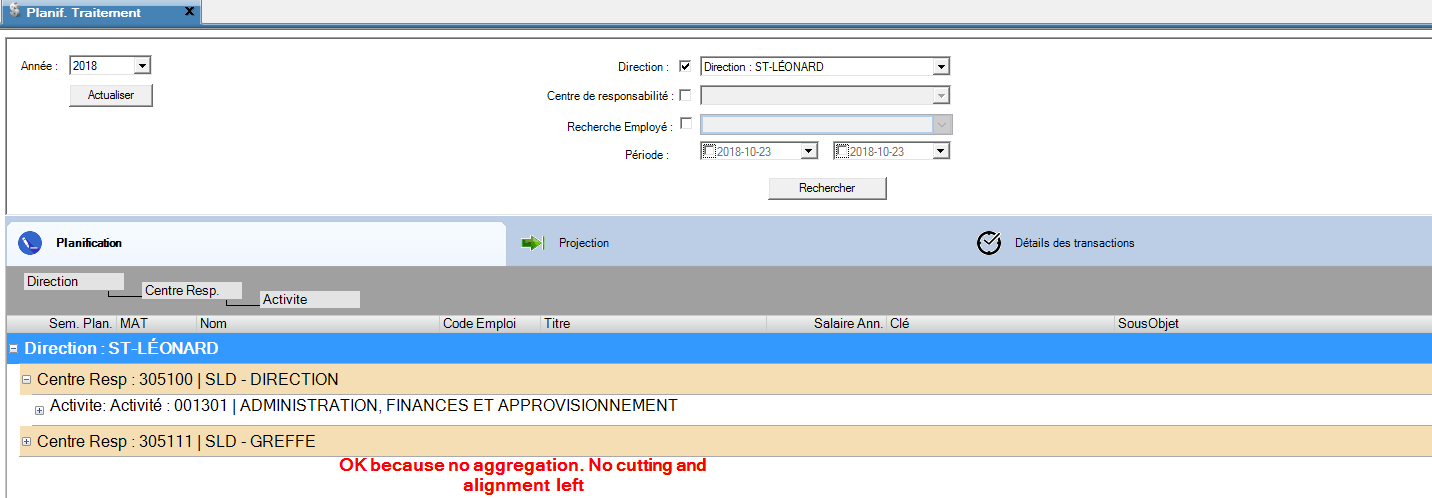

    There’s a display problem with the new truedbgrid v2018.03.
    When you group columns and aggregate others, the group header display is cut and the alignment changes
    Could you please fix this
