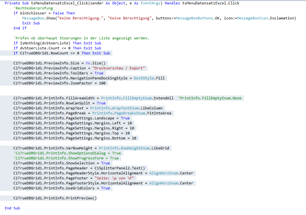

    how can I set the “export to file” selections only to xlsx.
    I “create” a window with the Statement: C1TrueDBGrid1.PrintInfo.PrintPreview()
    But how can I set the PrintPreview Settings before I create the Windows?
    A short info would be nice.
    Stephan

    Hello, thanks for your Reply.
    That is not what I’m looking for.
    try to explain it better :slight_smile:
    After the window with the printPreview appears, you are able to export (save as) the data in many different output files.
    BUT I only want to allow the export into Excel xlsx.
    Hope that the description is ok.
    Stephan
