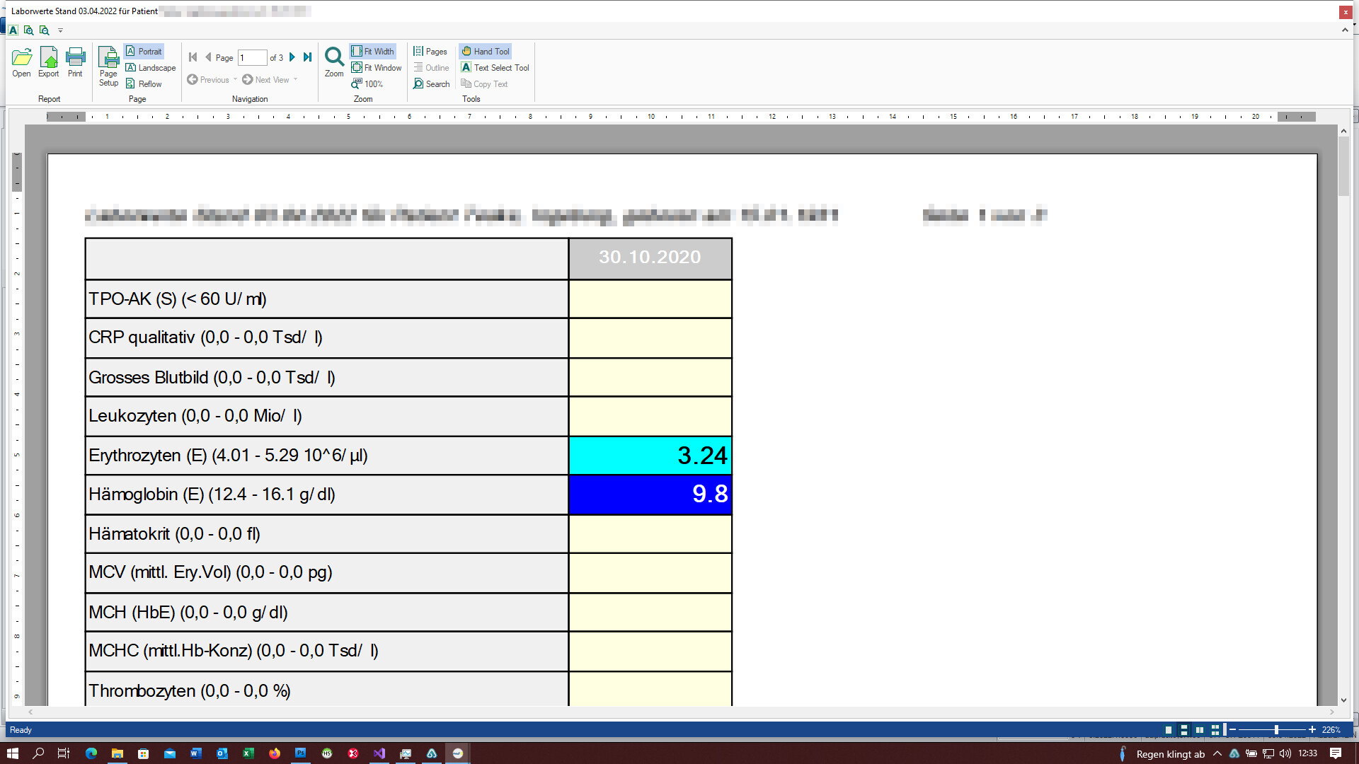

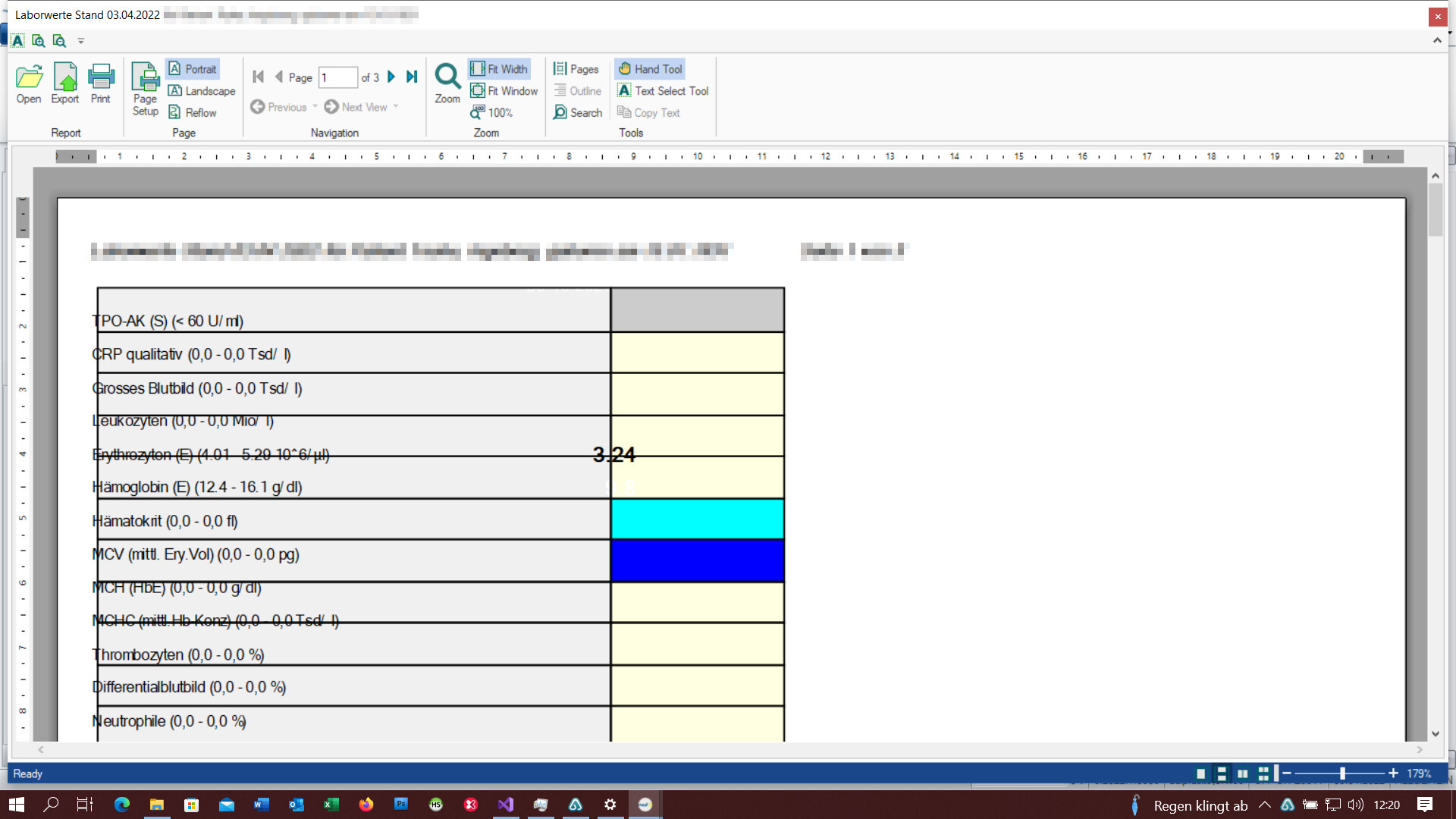

    I’ having some troubles with C1TrueDBGrid’s PrintInfo when Windows 10’s text size is set to 125%. Even though the Grid’s rows and cells are rendered correctly the cell texts aren’t resized and re-positioned accordingly. Please see both screenshots attached.
