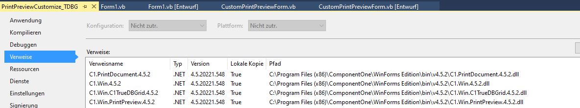

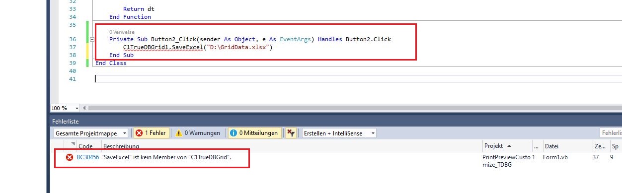

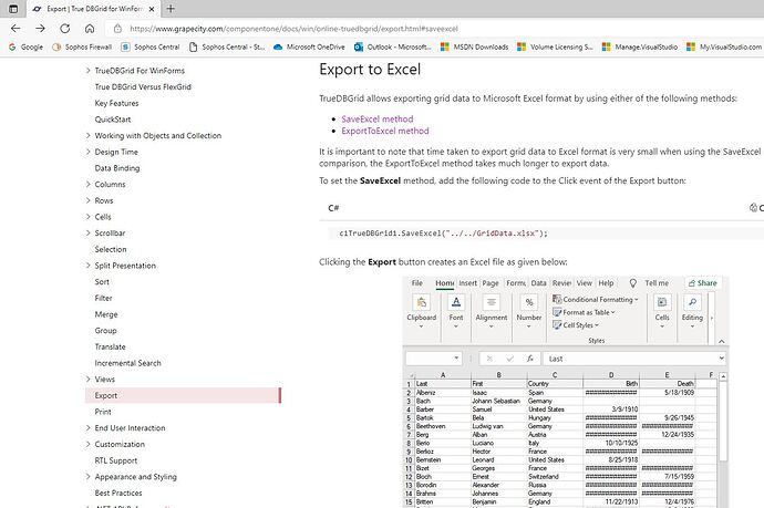

    I’m trying to use C1TrueDBGrid1.SaveExcel, as shown in the online-documentation of grapecity:
    https://www.grapecity.com/componentone/docs/win/online-truedbgrid/export.html#saveexcel
    It seems not to be existant, in the references in my VB-Project.
    It would be great if you can help me in this matter.
    Stephan
  • Posted 13 April 2022, 6:15 am EST
    Hi Stephan,
    To use the SaveExcel extension method, you will need to add a reference to the C1.Win.C1TrueDBGrid.Excel assembly in your project. Also, please make sure to add an Imports statement for the C1.Win.C1TrueDBGrid.Excel namespace, for the SaveExcel method to show in the Visual Studio.
