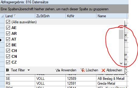

    Hi everbody,
    is it possible to show all possible entries in the Filterbar-Dropdown, mabye as a list, or is it possible to enlarge the shown entry-list?

    You can handle the MouseUp event of the C1TrueDBGrid to access the Filter Dropdown form by using the Application.OpenForms property. Then, you can increase the height of the Filter Dropdown form to show all of the entries at a time. Although, if you have a lot of entries in the dropdown, showing all of them at a time won’t be feasible. In that case, you can set the height of the dropdown form according to the height of the TrueDBGrid control or the Main form. Kindly refer to the attached sample showing the same.
    Please let us know if you need any other information.

    Hi Kartik,
    thanks for your reply.
    Since we have really a lot of entries, I will not use your code, but your code does work.
    Stephan
