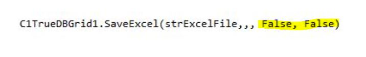

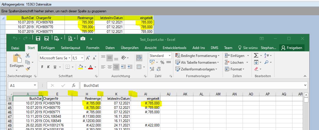

    In a C1TrueDBGrid I hid many columns, because I don’t need them in the excel file (you can see in the attached picture).
    The Excel export starts with:
    C1TrueDBGrid1.SaveExcel(strExcelFile, False, False)

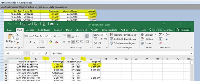

    In the created Excelsheet I do have some strange Entries an I hope you can help me:
    Why are there hashmarks in front of the values (those are Double values).
    Why are there the hidden columns?
    I hope you can help me.
    Stephan
  • Posted 22 April 2022, 3:38 am EST
    Hi Stephan,
    We could see both the issue at our end. We have reported the issues to the development team and will let you know as soon as we have an update. In the meantime, as a workaround, you can use the C1Excel to open the excel file after the export and manually do some post-processing to remove the hidden columns and fix the Format for the Double DataType cells. Kindly refer to the attached sample showing the same.
