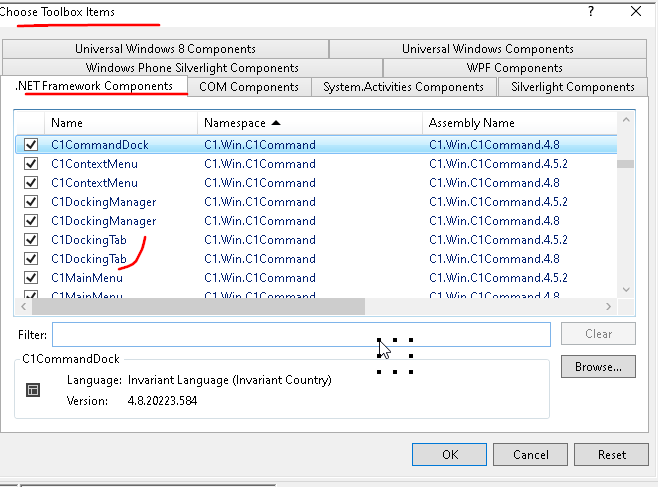

    I just try to edit Mymeq app. But C1DockingTabpages can not be selected and be edited. (VS2017 + ComponentOneControlPanel_20223.1.2).
    C1DockingTabpage is not show in toolbox;
    C1DockingTab is normal show in toolbox;
    No C1DockingTabpage option in .Netframwork component.(4.8)

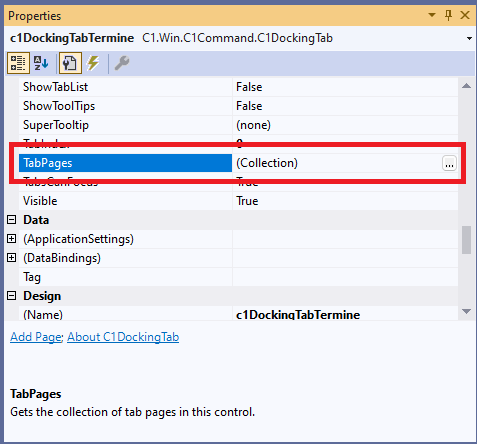

    you don’t add tab pages from the toolbox. Instead you select the C1DockingTab on your form, and in the property grid, search the property “TabPages”. The ellipsis button to the right opens a form where you can add or remove tab pages.

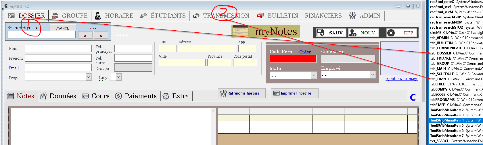

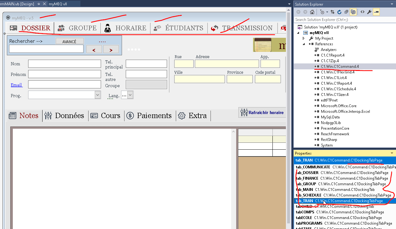

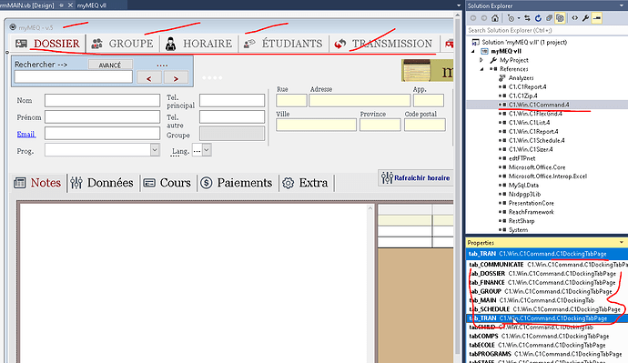

    But I can not edit/script between tabpages,
    Because in the VB.net code interface, I can’t switch the content between the tabpages.
    For example(See below screen), in VB. net, the content is the first tabpage(1-DOSSIER: ) is always displayed, I want to edit and modify the other tab Page(2-Transmission), click on the Transmission’s tab on top of screen , but the first tabpages are still displayed.

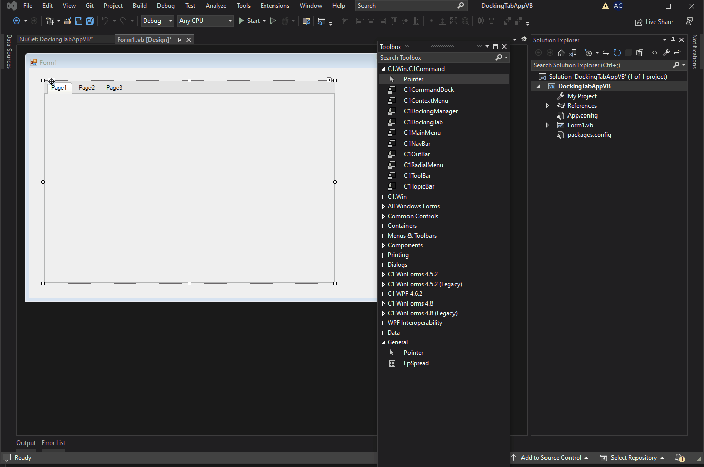

    As per Wolfgang, you can easily add TabPages in C1DockingTab via designer. As well as you can edit every single page content by selecting the particular TabPage in Designer Mode.
    Please refer the gif for the same.
    You have mentioned, that you are using Visual Studio 2017. We recommend use VisualStudio 2022 for better 4.8 designer support.
