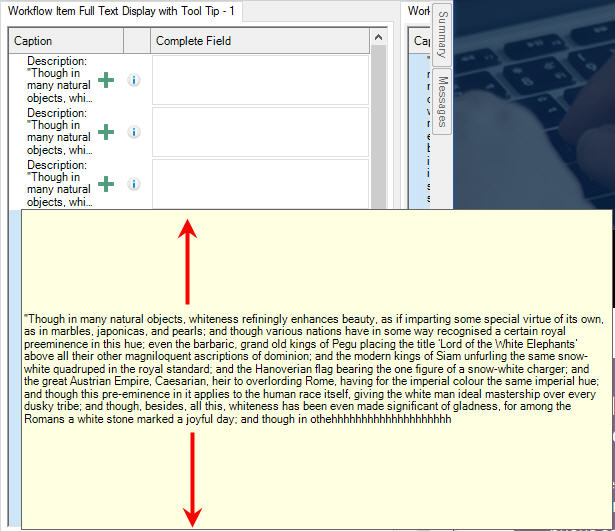

    Currently I’m having UI issue where the label has too much empty spaces as the image attached:
    This issue happens when the Cell is greater than the Form/Control size and ShowCellLabels=True
    Is it possible to adjust the height of the label show?

    For now, we don’t have the functionality to modify the tooltip height with ShowCellLabels. As a workaround, you can use C1SuperTooltip to achieve this, just set the C1SuperTooltip on the cells using the MouseMove event and then you can change the location by the PopupEventArgs’ Location property and fix the maximum width by the MaximumWidth property of the C1SuperToolTip in the Popup event handler whenever the text in a cell is partially visible.
