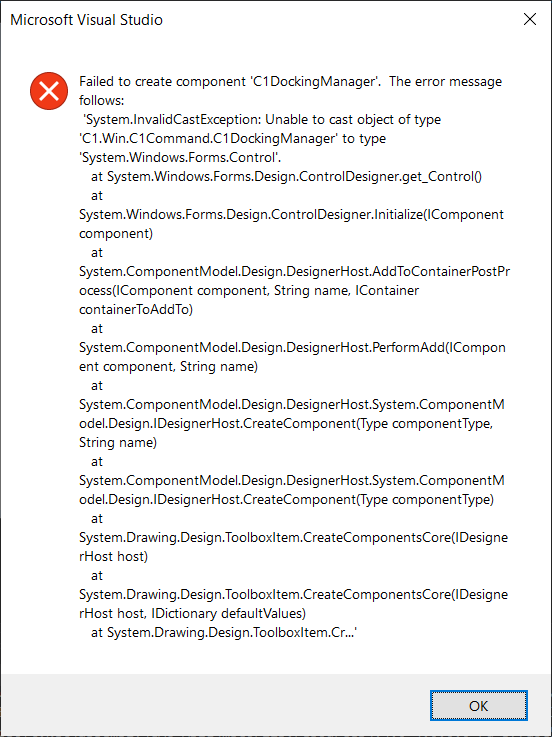

Can't place the C1DockingManager on the form
Posted by: mkskr on 3 March 2021, 3:29 am EST
    Posted 3 March 2021, 3:29 am EST - Updated 3 October 2022, 11:21 pm EST
    Hello!
    Why can’t I place the C1DockingManager (4.0.20183.338) on the form? I am using Visual Studio 2019.
  • Posted 4 March 2021, 12:16 am EST
    Hi Korolev,
    Please refer to the “‘Failed to Create Component’ Design Time Exception” section of the below-given blog post, which demonstrates how to resolve it:
    https://www.grapecity.com/blogs/a-step-ahead-troubleshooting-common-errors-part-i
