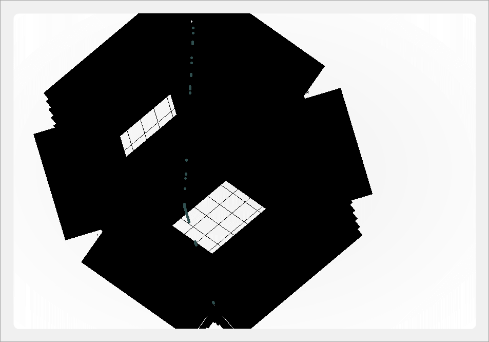

    The Chart3D on one of my applications has gone haywire over the past 2 days. There were no code changes at all or version updates but the axes are now being drawn so thick that the chart is nearly completely obscured (at least it seems like the axis thickness). I attached a picture. Anyone know what’s going on here/seen this before?

    This issue was caused after a recent windows update and its fix will be available with the upcoming release i.e. 2021v3. We have arranged a private build on the support case, please continue the thread there [CAS-26170-B3V8S3].
