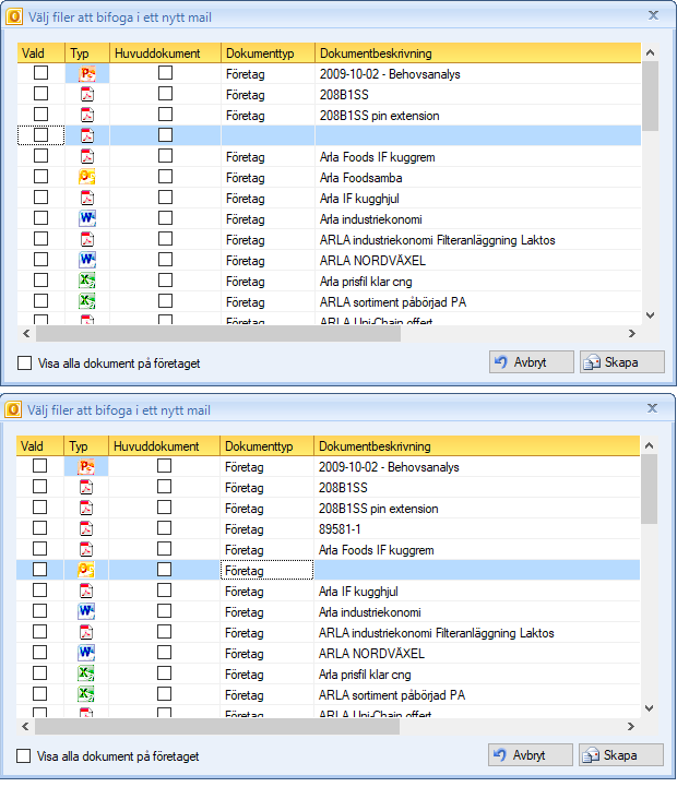

    What is the reason that columns are not displayed correctly?
    Please look at the included example.
    I know we had this problem several years ago, but I cant remember what to change to fix this problem!

    Hi Peter,
    We tested the latest version of C1FlexGrid (4.8.20231.596) and could not see any such issues on our end. Please see the attached sample project for reference. The issue you are facing might be observed if you are handling the OwnerDrawCell event and somehow bypass the cell’s content drawing.
    Therefore, we request you to please provide a sample project or update the attached project to show your implementation and the issue you are facing. This will help us investigate the issue further and assist you better.
