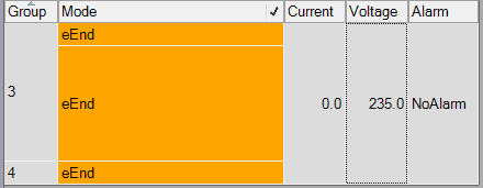

    Hi
    Any way to control the height of a merge row
    In the image i have my grid, i would like to make the middle row is is a merge of 3 the
    same height as the other 2 rows

    *I am assuming you are using C1FlexGrid.
    Now, for customizing the height of merged row, you may use OwnerDrawCell event and inside check if GetMergedRange returns SingleCell/not. If it does not return SingleCell that means that the cell is part of a merged range and you can then change the height of that row as shown in below code snippet:```
    private void _flex_OwnerDrawCell(object sender, C1.Win.C1FlexGrid.OwnerDrawCellEventArgs e)
    if(!e.Measuring)
    var test = _flex.GetMergedRange(e.Row, e.Col);
    if (!_flex.GetMergedRange(e.Row, e.Col).IsSingleCell)
    _flex.Rows[e.Row].Height = 100;
