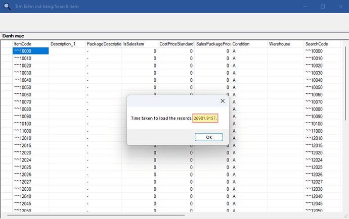

  • Posted 30 April 2024, 3:46 am EST - Updated 30 April 2024, 3:52 am EST
    HI Kartik,
    1, You can download from the link:
    https://drive.google.com/file/d/1BSY_6ZplCdCvZWFG0YB7poTIUFuAOSRq/view?usp=sharing
    2, See attached photo
    3, C1.Win.C1FlexGrid.4.8; version: v4.0.30319
    C1.DataCollections; version: v4.0.30319
    4, My environment:
    _ Windows 11 Pro, version 22H2
    _ 12th Gen Intel(R) Core™ i7-12850HX 2.10 GHz
    _ RAM: 32MB
    _ 64-bit operating system

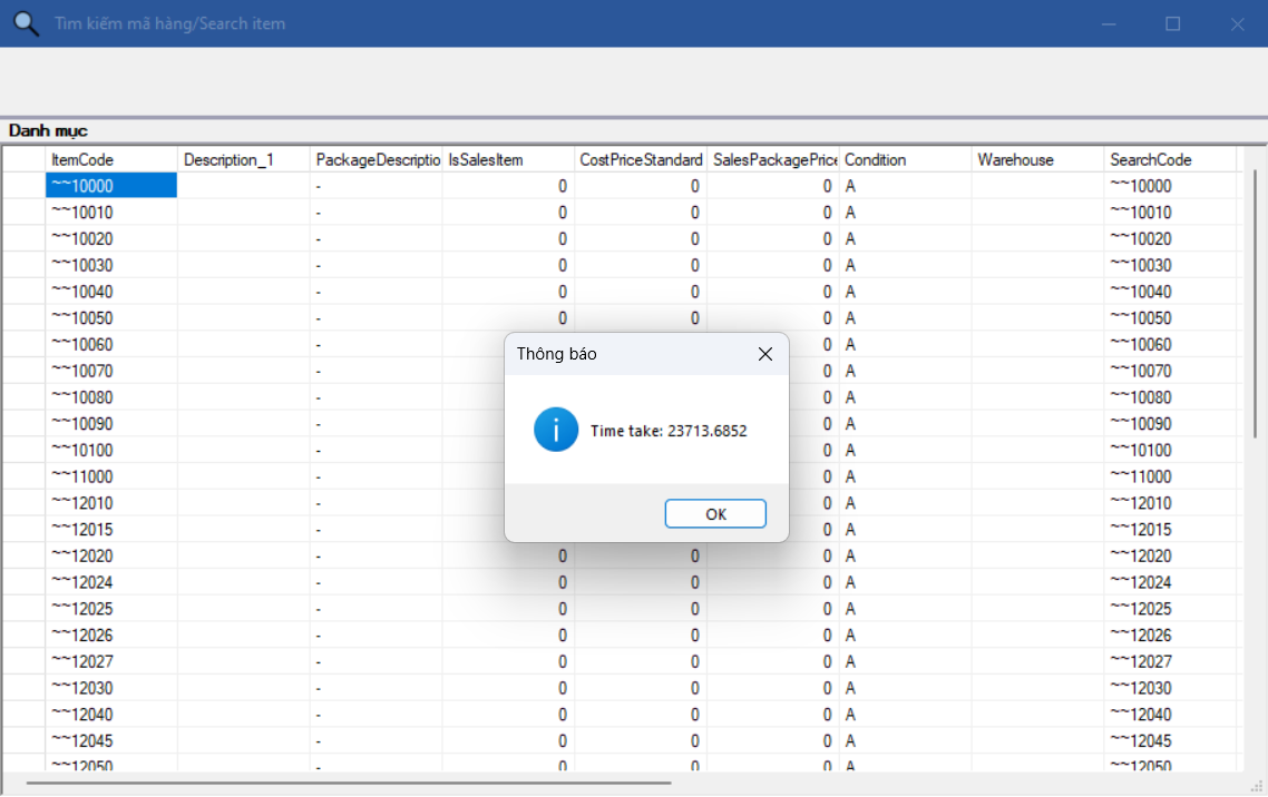

  • Posted 2 May 2024, 10:18 am EST - Updated 2 May 2024, 10:23 am EST
    Hi Kartik,
    Time is still high.
    Could you pls share your testing code project.
    The C1flexgrid that I have checked the **Version **as attached file.
    Duyet Le

  • Posted 2 May 2024, 11:00 pm EST
    The time is as attached photo.
