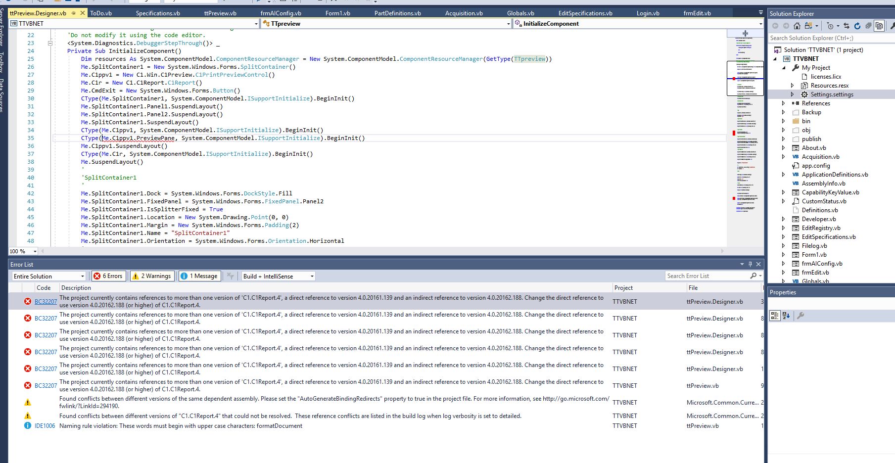

  • Posted 7 May 2018, 1:20 pm EST - Updated 4 October 2022, 2:42 am EST
    Here is a screen shot and the license file.
    C1.Win.C1Command.C1CommandDock, C1.Win.C1Command.4
    C1.Win.C1Command.C1ContextMenu, C1.Win.C1Command.4
    C1.Win.C1FlexGrid.C1FlexGrid, C1.Win.C1FlexGrid.4
    C1.Win.C1Chart.C1Chart, C1.Win.C1Chart.4
    C1.Win.C1Command.C1MainMenu, C1.Win.C1Command.4
    C1.Win.C1Command.C1CommandHolder, C1.Win.C1Command.4
    C1.C1Report.C1Report, C1.C1Report.4
