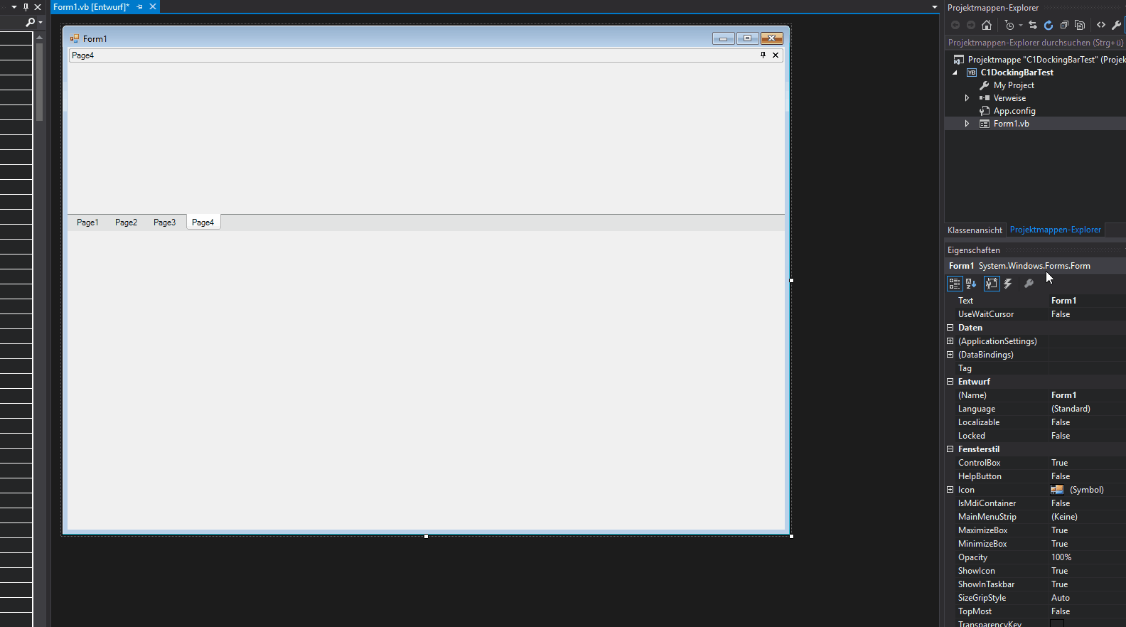

  • Posted 20 April 2018, 11:11 am EST - Updated 4 October 2022, 2:48 am EST
    AllowFloat=False … I can dock the pages somewhere, the pages cannot be UNdocked (they cannot float), after the first dock, I cannnot grab and dock them again… please see the gif.

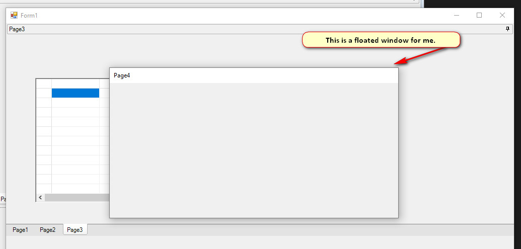

    I “just” want to be able to repeat to dock as it is possible with Autofloat=True, but not allow the user to end up with a floated window. See my attached screenshot.
    Hope you understand.

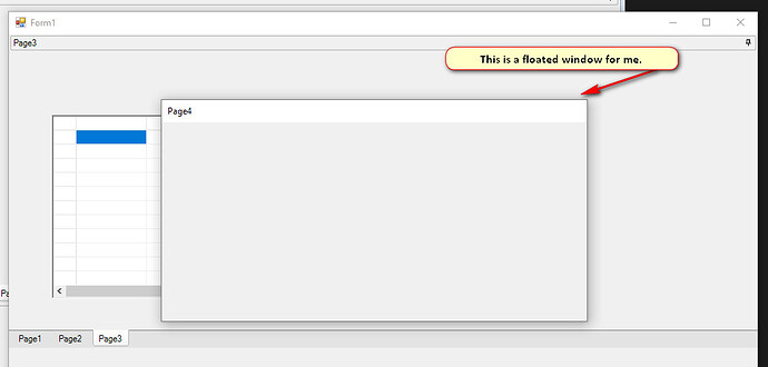

  • Posted 23 April 2018, 11:39 am EST

    You can make use of the C1DockingManager’s Floating event to restrict the floating of the C1DockingTab and the tab pages while AllowFloat=True. This way, you’ll be able to move the tabs around, without actually having them floating on the form. You can learn more about C1DockingManager from the below mentioned documentation link:
    http://helpcentral.componentone.com/nethelp/c1command/C1.Win.C1Command.4~C1.Win.C1Command.C1DockingManager_members.html
    A sample has been attached for your reference.
