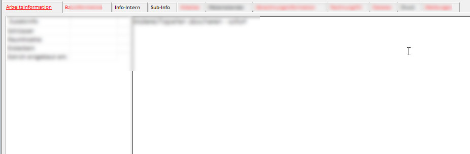

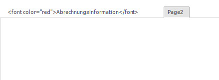

    I would need the possibility to change the font (colors and attributes) of each Tab seperately as seen in a screenshot of an older app. An easy try with easy html in the .text propert doesnt seem to work.
    Is there an easy way to achieve this?
