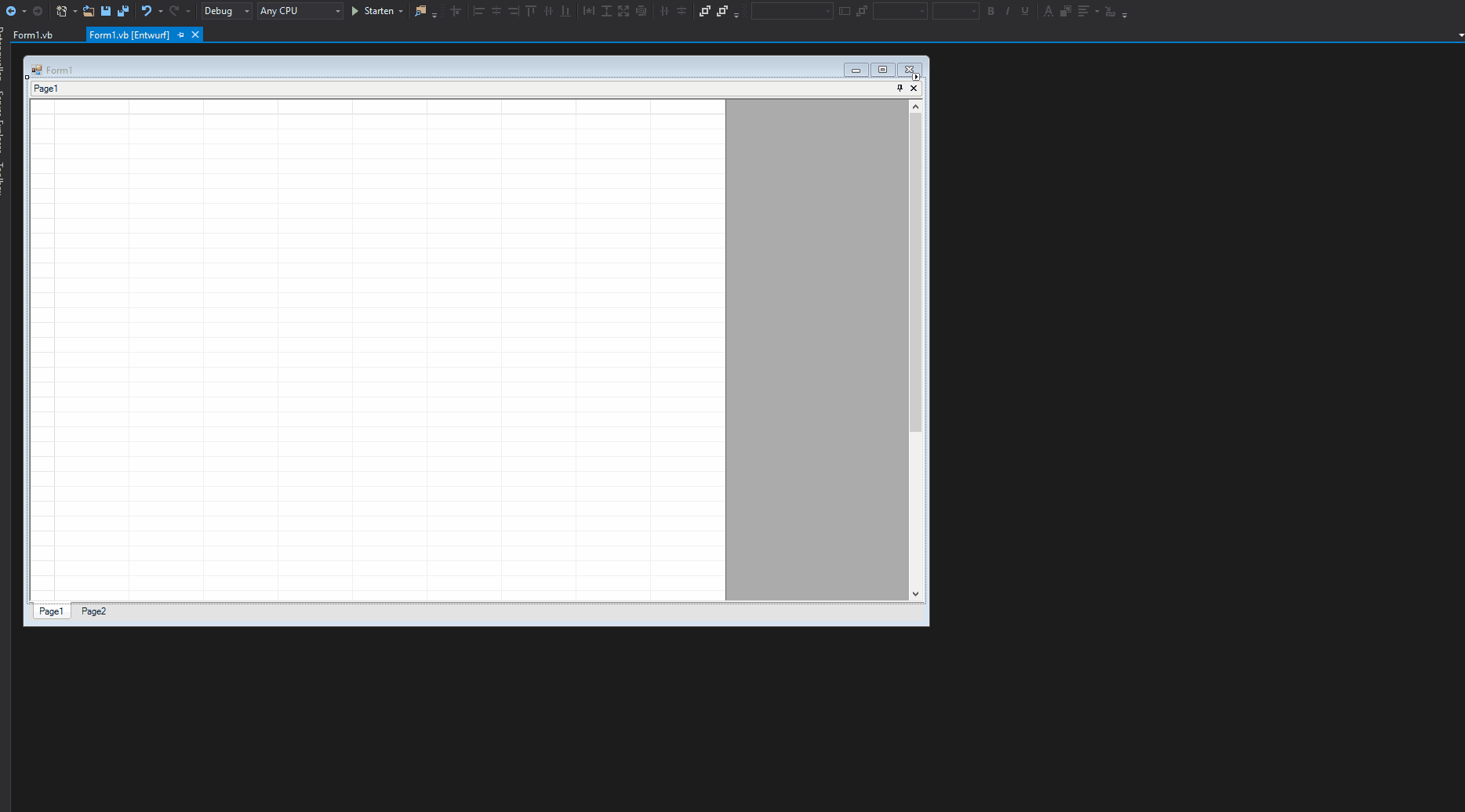

    DockingTab:SaveLayout and RestoreLayout are not working correctly.
    I have reduced my original project to the essential parts. How can I send it privately? I also made some screenshots and have the Layout.xml File
  • Posted 21 June 2018, 9:39 am EST - Updated 4 October 2022, 1:59 am EST
    This is a reduced to the minimum project plus gif that shows how the layout.xml file is restored incorrect.DockingBarSaveLoadLayoutTest.zip
