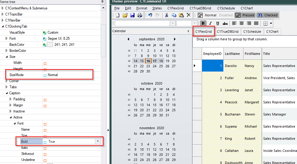

    I’m encountering two issues with the C1DockingTabPage.
    First, I try to set the text in the tab selected bold with the themecontroller but it’s not taken into account:
    Another issue, I’m setting the tab item size through the designer but when running the app, the tab are reduced to fit to text (even if in the theme, it’s set to “normal”.
    Am i missing something?
  • Posted 17 September 2020, 3:46 am EST
    >>First, I try to set the text in the tab selected bold with the themecontroller but it’s not taken into account.
    Please set the font property as shown in the attached screenshot docking1.png.
    Sorry, we do not face the issue at our end, please see the attached screenshot docking22.png for reference.
    I have also attached a sample which is working fine at our end, if you are doing something else then please modify the sample accordingly.
    DockingTabThemeIssue.zip
    docking1.png.zip
    docking22.png.zip
  • Posted 17 September 2020, 5:00 am EST
    OK, I understand that the font properties must all be set to something to be taken into account by the theme controller. Works fine now.
    For itemsize, it’s only taken into account if I set it in the load event, not in the designer.
