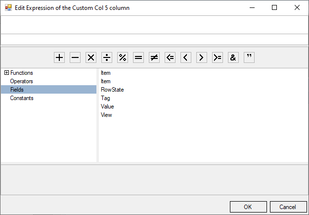

    I am unable to get the Expression Editor to work with the C1Flexgrid when using a C1.LiveLinq.LiveView as my data source. The View is working as the datasource for the grid, however, the fields are not recognized by the expression editor. The ViewRow Object fields are presented and not my collection fields - see the attached screen shot.
    Is this a limitation?

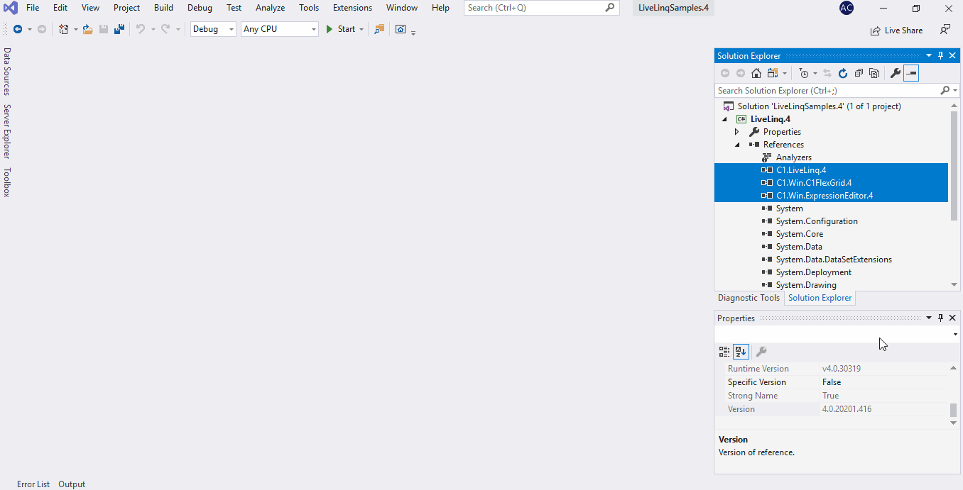

    I am sorry to say but as per the tests at our end the issue is fixed. I tested the same application with 2020v1 and old release builds and observed the following. As you can see, in the first video (using 2020v1 release build) the fields appear properly as expected.
    So, could you send across some files that can help us learn more about the issue you are still facing.
    Ruchir
